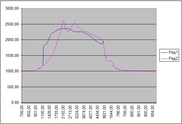

Сообщение andrey_020 » 22 июн 2011, 08:20
В общем вчера сделал заезды на 3 педераче до красной зоны и снял лог в 2 экз.
Tuesday,19,October,2010,18:43:09:46862,VCDS Version: Release 10.6.0,Data version: 20100630
03G 906 018 CE,,R4 2.0l PPD1.5 G 9384,
,Group A:,'011,,,,Group B:, Not Running,,,,Group C:, Not Running
,,RPM,Absolute Pres.,Absolute Pres.,Lambda,,,,,,,,,,
,TIME,,,,,TIME,,,,,TIME,,,,
Marker,STAMP, /min, mbar, mbar, %,STAMP,,,,,STAMP,,,,
,0.11,1659,1663.0,1749.4,61.4,,,,,,,,,,
,0.27,1684,2232.0,1789.9,77.6,,,,,,,,,,
,0.40,1712,2287.1,1869.6,70.1,,,,,,,,,,
,0.55,1754,2303.4,1947.8,61.2,,,,,,,,,,
,0.69,1786,2309.2,2029.6,53.1,,,,,,,,,,
,0.84,1826,2317.5,2131.2,49.3,,,,,,,,,,
,0.98,1869,2325.6,2207.6,44.6,,,,,,,,,,
,1.12,1914,2335.8,2287.1,41.9,,,,,,,,,,
,1.27,1965,2342.6,2370.9,38.6,,,,,,,,,,
,1.42,2000,2352.2,2478.6,33.9,,,,,,,,,,
,1.56,2042,2352.2,2580.6,24.3,,,,,,,,,,
,1.70,2101,2352.2,2601.0,22.7,,,,,,,,,,
,1.84,2148,2352.2,2530.1,34.7,,,,,,,,,,
,2.00,2207,2352.2,2391.2,42.2,,,,,,,,,,
,2.14,2255,2352.2,2313.6,39.5,,,,,,,,,,
,2.28,2303,2352.2,2268.0,38.4,,,,,,,,,,
,2.42,2354,2352.2,2245.4,37.8,,,,,,,,,,
,2.58,2407,2352.2,2241.0,36.2,,,,,,,,,,
,2.72,2454,2352.2,2251.0,34.6,,,,,,,,,,
,2.86,2505,2352.2,2273.0,33.0,,,,,,,,,,
,3.00,2553,2352.2,2304.0,32.2,,,,,,,,,,
,3.16,2604,2347.8,2350.6,29.8,,,,,,,,,,
,3.30,2657,2329.3,2397.0,27.0,,,,,,,,,,
,3.44,2703,2317.5,2440.4,21.9,,,,,,,,,,
,3.58,2756,2307.4,2480.0,19.9,,,,,,,,,,
,3.74,2813,2296.2,2519.4,18.0,,,,,,,,,,
,3.88,2862,2286.0,2529.6,17.3,,,,,,,,,,
,4.02,2912,2275.8,2520.0,17.0,,,,,,,,,,
,4.16,2967,2265.4,2500.0,17.1,,,,,,,,,,
,4.32,3019,2251.8,2470.1,16.8,,,,,,,,,,
,4.46,3063,2251.8,2458.2,16.7,,,,,,,,,,
,4.60,3109,2251.8,2437.8,16.4,,,,,,,,,,
,4.74,3160,2251.8,2420.6,15.7,,,,,,,,,,
,4.89,3196,2251.8,2410.8,15.0,,,,,,,,,,
,5.02,3249,2251.8,2401.0,14.8,,,,,,,,,,
,5.17,3292,2251.8,2391.2,14.1,,,,,,,,,,
,5.31,3338,2251.8,2381.4,13.8,,,,,,,,,,
,5.46,3385,2251.8,2362.0,14.0,,,,,,,,,,
,5.61,3417,2251.8,2346.0,14.4,,,,,,,,,,
,5.74,3458,2251.8,2330.0,14.2,,,,,,,,,,
,5.89,3492,2251.8,2315.4,14.1,,,,,,,,,,
,6.04,3548,2251.8,2299.2,13.9,,,,,,,,,,
,6.18,3586,2251.8,2288.2,13.5,,,,,,,,,,
,6.33,3626,2231.0,2283.4,11.9,,,,,,,,,,
,6.46,3665,2217.2,2277.0,11.4,,,,,,,,,,
,6.62,3713,2204.2,2270.0,10.7,,,,,,,,,,
,6.76,3750,2196.7,2265.1,10.4,,,,,,,,,,
,6.90,3788,2187.0,2256.2,9.9,,,,,,,,,,
,7.04,3824,2187.0,2245.8,10.0,,,,,,,,,,
,7.20,3866,2170.1,2235.2,8.8,,,,,,,,,,
,7.34,3904,2153.9,2224.6,8.3,,,,,,,,,,
,7.48,3945,2153.9,2215.5,8.1,,,,,,,,,,
,7.62,3975,2150.4,2207.5,7.6,,,,,,,,,,
,7.78,4018,2128.5,2197.9,6.6,,,,,,,,,,
,7.92,4051,2128.5,2189.6,6.8,,,,,,,,,,
,8.07,4089,2119.0,2180.0,6.0,,,,,,,,,,
,8.20,4126,2080.8,2168.3,5.0,,,,,,,,,,
,8.36,4161,2057.2,2157.1,5.0,,,,,,,,,,
,8.51,4192,2040.0,2146.2,5.0,,,,,,,,,,
,8.63,4225,2032.8,2138.4,5.3,,,,,,,,,,
,8.78,4260,2032.8,2128.5,5.5,,,,,,,,,,
,8.93,4294,1998.0,2116.8,5.0,,,,,,,,,,
,9.07,4315,1977.6,2110.2,5.0,,,,,,,,,,
,9.21,4338,1966.1,2102.4,5.0,,,,,,,,,,
,9.36,4373,1966.1,2096.6,5.3,,,,,,,,,,
,9.51,4400,1944.8,2088.0,5.0,,,,,,,,,,
,9.65,4428,1924.3,2080.1,5.0,,,,,,,,,,
,9.79,4458,1908.0,2072.6,5.0,,,,,,,,,,
,9.94,4476,1897.3,2061.7,5.2,,,,,,,,,,
,10.09,4508,1897.3,2049.2,5.4,,,,,,,,,,
,10.23,4540,1885.0,2037.3,5.0,,,,,,,,,,
,10.38,4553,1876.8,2023.6,6.9,,,,,,,,,,
,10.51,4483,1988.8,1988.8,18.4,,,,,,,,,,
,10.67,4094,1769.3,1769.3,33.7,,,,,,,,,,
,10.81,3770,1581.0,1581.0,37.8,,,,,,,,,,
,10.95,3473,1458.6,1458.6,40.8,,,,,,,,,,
,11.09,3198,1387.8,1374.8,48.7,,,,,,,,,,
,11.25,2923,1326.2,1321.9,56.5,,,,,,,,,,
,11.39,2686,1310.8,1310.8,61.3,,,,,,,,,,
,11.53,2459,1316.0,1317.4,65.4,,,,,,,,,,
,11.67,2243,1324.0,1325.3,69.8,,,,,,,,,,
,11.83,2013,1328.2,1328.2,73.8,,,,,,,,,,
,11.97,1815,1326.6,1326.6,10.0,,,,,,,,,,
,12.11,1647,1319.8,1319.8,10.0,,,,,,,,,,
,12.25,1517,1248.5,1235.8,10.0,,,,,,,,,,
,12.41,1360,1178.7,1170.4,10.0,,,,,,,,,,
,12.56,1237,1134.0,1129.0,80.0,,,,,,,,,,

Сообщение andrey_020 » 22 июн 2011, 08:21

Блин, сто можно из этого понять, ну время, ну обороты, необходимое давление и измеренное давление и участие атмосферы.
Но как это можно все связать и сказать нормально она работает или нет???? не знаю.

Сообщение Fast » 22 июн 2011, 08:51
В папке с ваг-комом есть ехе файл - tdigraph или что-то типа того называется, строит графики по логам. Ну а я сейчас постараюсь посмотреть это...
Fast
Сообщения: 2012
Откуда: Могилев, РБ
Re: Какие симптомы у умирающей турбины
Сообщение Fast » 22 июн 2011, 09:36
Смотрим! Синий график - что хотят мозги по ситуации(разгоняемся). Розовый график - что в итоге выдает турбина.
Видим, что мозги уже хотели наддув с 1,200 оборотов поднять и к 2000 выйти на максимум, а турбина вяленько поднимала давление, причем так "увлеклась", что ушла в передув, но силенок не хватило и давление упало, потом снова в передув, а вот сброс газа она смогла в итоге. Итого нужно смотреть геометрию и её управление. В идеале графики должны совпадать. В приведенных выше логах два таких графика. И там визуально видно отставание и передув. Максимум желания мозгов 2352,20 (т.е. 1,3 бара наддува), а турбина смогла 2601,00 (соответственно 1,6 бара).

Сообщение andrey_020 » 22 июн 2011, 09:43
Fast
Т.е. необходимо, все таки, снимать турбинку и чистить геометрию или может проблема в грибке???
и как мне увидить этот график у себя в компе, что нужно нажимать чтобы видеть график??? Это нужно делать при испытании? Я сейчас попробовал открыть эту папку ТДИграфт, у меня выскочила ошибка и на графике видны только 3 наклонные, разноцветные прямые.

Сообщение Fast » 22 июн 2011, 09:55
andrey_020 писал(а):Fast
Может и в грибке, но скорее всего геометрия. Она или не отрабатывает весь диапазон или скорее всего висит в одном положении(для высоких обротов), поэтому пока обороты низкие давление не получается, а потом когда нужно бы ограничить рост наддува, тоже ничего не получается - дует сколько сможет.
По построителю графика ничего не скажу - не помню, нужно смотреть. Но должно быть все нормально - свои графики он строить должен. Там вроде в самом ваг-коме кнопочка была - нажал и сразу графики смотришь. Не помню, давно не трогал этого. Эти графики я построил в Экселе по-быстрому.

Сообщение andrey_020 » 22 июн 2011, 10:02
Fast
Нашел я как их делать, но у меня еще 2 полосы с оборотами двигателя и забором атм. воздуха, щас свой график попробую вставить.

Сообщение andrey_020 » 22 июн 2011, 10:28
перенести сюда не получилось, видимо не грамотный я в компах((((((, но по данным, вышеизложенным 2-ум вариантам, графики эдентичны!!!!
А может все это происходить от забитого катализатора? Сначала он не дает нормально раскрутить турбину (газы не выходят), а потом когда давление выросло не достаточно быстро выбрасывает газы. Такая легенда может жить?

Сообщение Fast » 22 июн 2011, 12:46
Ну я и сказал:
Нет, не может. Отстань уже от катализатора. ;) Если он забился, то авто просто не едет, обороты не набирает, скорость не развивает. Тем более, что у тебя передув. С забитым катализатором график того что выдает турбина был бы на всем диапазоне ниже графика того что хотели мозги.
